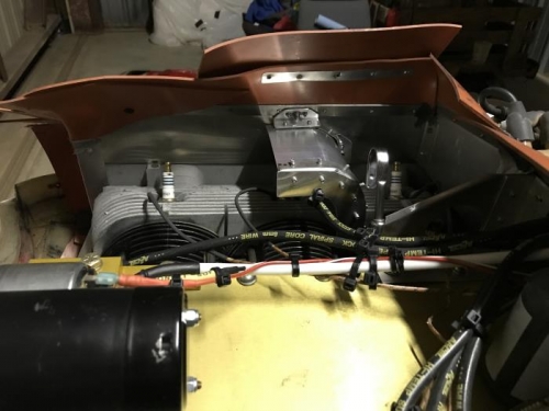

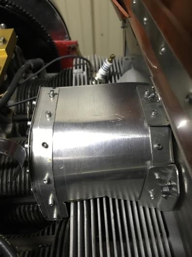

Brief Description:  Internal cowl flap
I've consistently had trouble with #3 cylinder getting to the max temps well ahead of the rest. Of course, its a middle cylinder and is on the side of the ascending blade. I made a simple deflector to direct more air through the cooling fins of this cylinder. It works! I finally got the cylinder head temps balanced!
