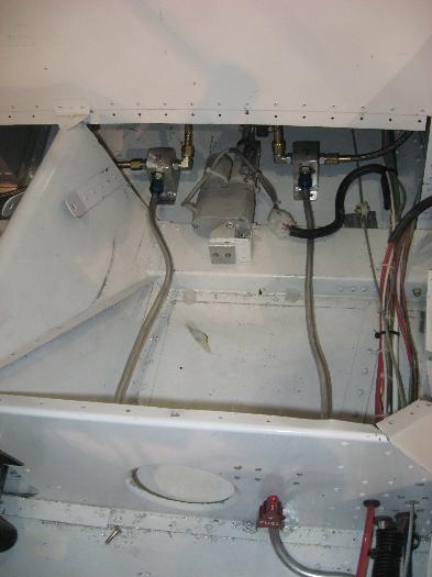

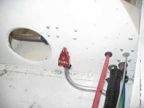

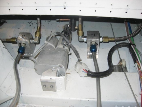

Brief Description:  Fuel System lines
I spent the day running the hard lines for fuel. From the tanks to the gacolators I ran stainless braided lines for flexability and then ran hard aluminum for the rest with AN fittings. I mounted the fuel valve under the Pilot seat with only the valve sitting through the bulkhead. I will label appropriatly.
Fuel Shut off valve
Fuel Shut off valve
Low point in the fuel system.
