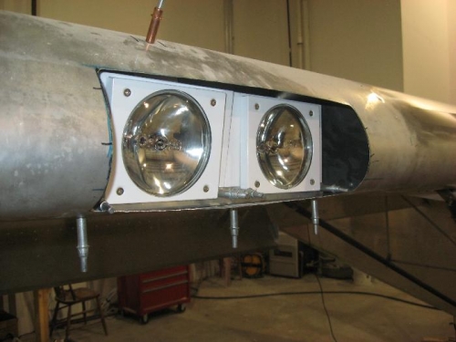

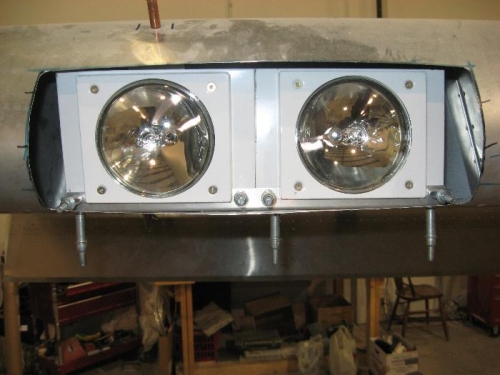

Finally got back to work on my landing and Taxi lights.
I figured out how i was mounting in the wing and how I was making them accessible for bulb replacement.
I formed a lexan glass cover. Nut plates and screws to the perimeter counter sunk. Landing light is cocked forward as you can see, so that durning the higher angle of attack during landing it is still on the runway. the Taxi light is straight and level forward.
I will disassemble and paint the interior. As well I will seal off from the rest of the wing cavity.
