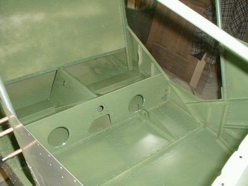

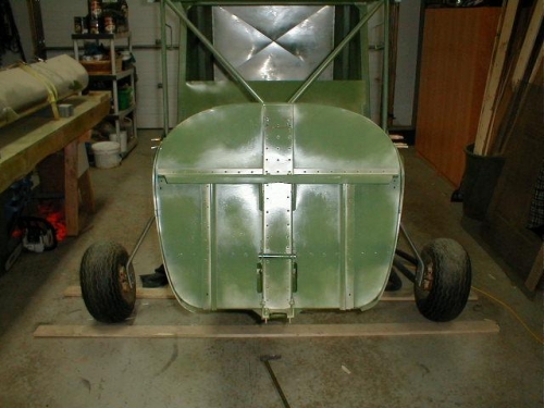

Date:  1-6-2008
Number of Hours:  9.00
Brief Description:  Prime Sealed and Painted Cabin and Firewall
Throughly cleaned the entire cabin and firewall with laquer thinner and then with a scotch brite pad (red). Then sprayed with Endura aircraft primer and sealer. 3 very light coats about 30 mins between coats.
Foggy?
Foggy?
