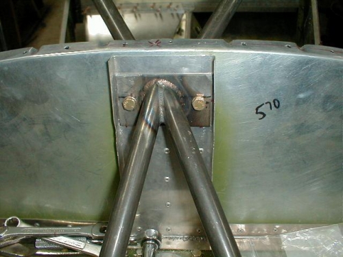

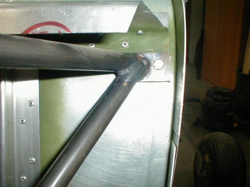

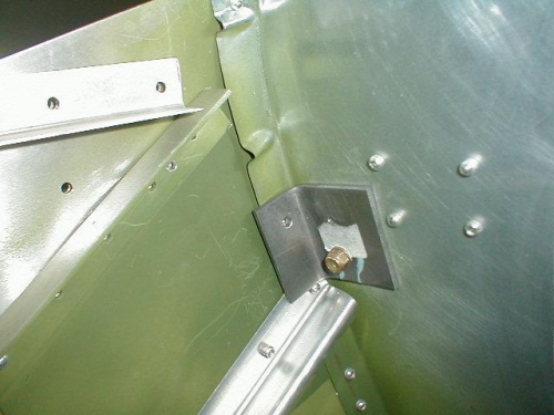

Brief Description:  Completed mounting the engine bracket
I completed drilling and attaching all support bolts for the engine bracket. I removed the top skin in order to better access the bolts and nuts as well as aligning the backer plates for the upper mounts. I changed out the two top mount bolts for AN10-5A bolts as I made the holes slightly larger to get them aligned. Ready now to be reoved and painted.
side mounts engine side
Inside the cabin back plate for side mounts
Top Bracket. I did cgange these to larger bolts
