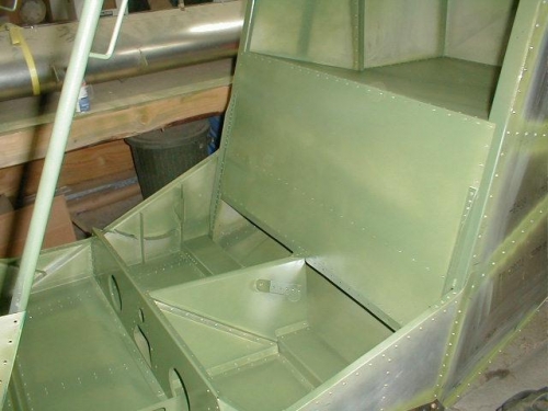

I completed riveting the side rail doublers to the fusalage.
Built the curved seat supports. I did add an extra seat support to both seats and curved them to better contour to the seats. As well I extended the seat back panel with a 50mm wide band so that I could drop the seat bottoms an additional 30m to help with head room.
