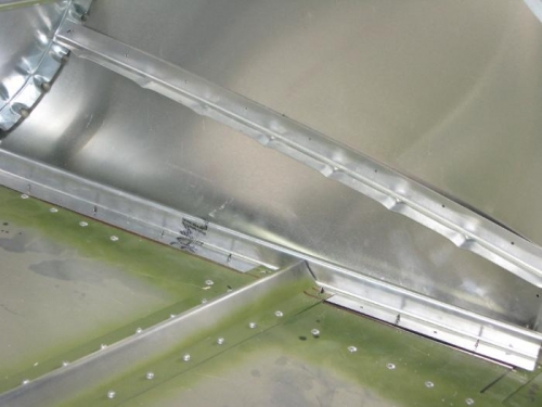

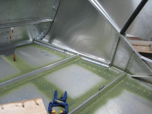

I started to add the required braces on the side skins. These ran from the side panel to the firewall. There was a zee brace on the bottom, a hand crimped L angle to hold the shape and then another Zee brace and then a final L angle on the top where the two skins wil eventually meet.
Zee brace at base of skin from firewall back
Hand crimped L angle on side skin

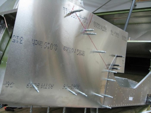

Drill and cleco side skin
