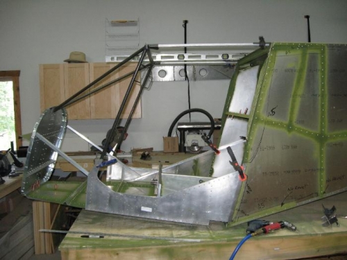

I measured and cut the cabin tubing as described in the instructions. Set the aircraft level by pulling th estring line from end to end at the set points. Leveled the cabin and checked for squareness and level.

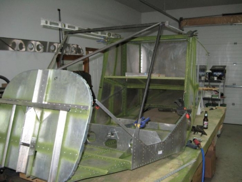

Set the firewall and frame on the fuselage.
Everything is lined up ready to drill

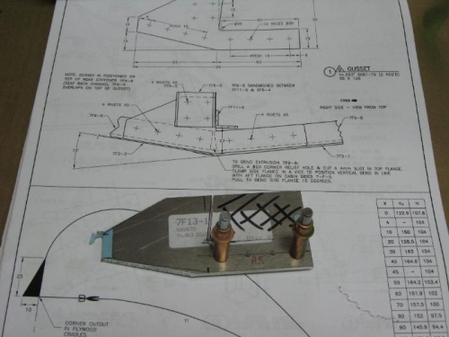

Making the gussets for strengthing the attachment point
