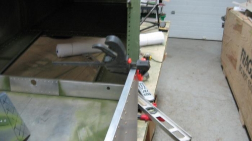

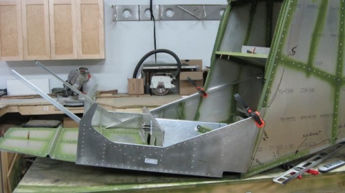

Attached the front and rear fuselage. First I clamped and spent an hour or two just to ensure it was lined up right. I decided to install the cabin structure before I drill anything . This way I will be lined up.
Clamped in place
Clamped in place
