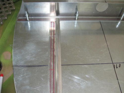

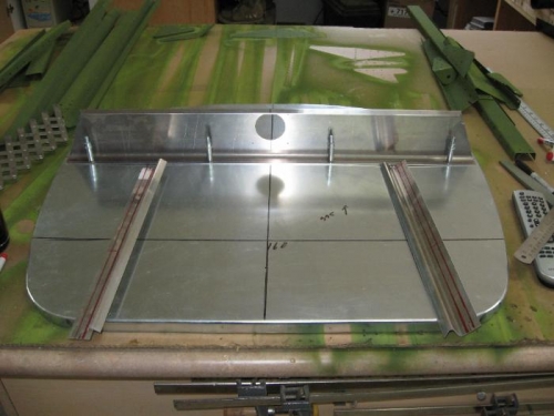

Laid out the firewall as per the instructions. First piece on was the upper channel. It came pre drilled which was nice. Marked the rivet lines for the vertical zee channels that are on either side.
Layout on firewall
Layout on firewall
Note do not rivet at the bottom 3inches of the zee chanels or the ends of the upper channel.
