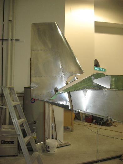

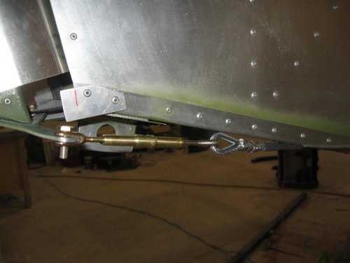

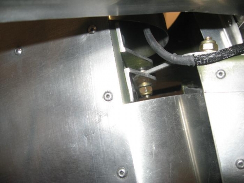

Brief Description:  Final Rudder Assembly
I installed rudder lower fairings and did the final assembly to the rudder. Ran the control cables and crimped the cables. Checked the deflection. OK. Installed rudder stops. Not easy to get the mounting bolts in with the appropriate washers for spacers.
