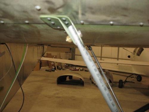

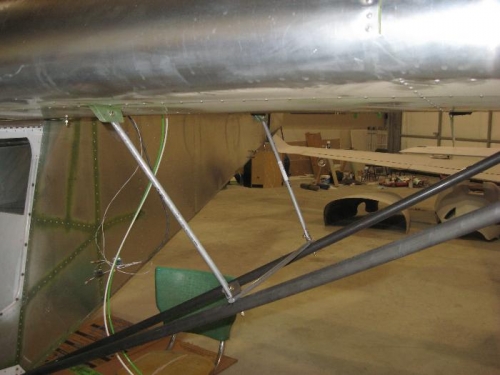

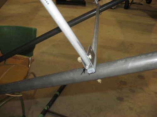

Brief Description:  Installed Jury Struts
Spent a couple of hours installing the Jury Struts on the left wing. Rounded off the aluminum inserts and placed in the ends of the tubes. I put them in the vice and squeezed them flat up to about 50 mm in from each end. Drilled and and mounted on Struts as per the plans.
