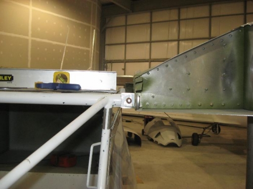

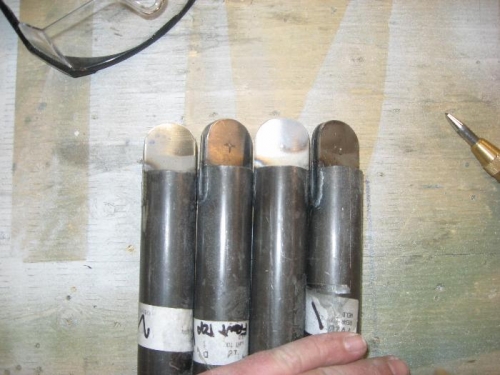

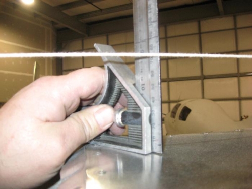

Brent left and Michelle showed up to help with the other wing. I set the dehidral at 75mm off the spar at the root. Dry fit the struts and drilled and cleco'd. I bolted the leading edge of the wing root.
Measured from the trailing edge outboard to the tail of the fuselage on both sides there was only a 12mm difference.
75 mm both wings at wing root
Leading edge wing attachment bolted
Strut ends rounded off on the grinder
