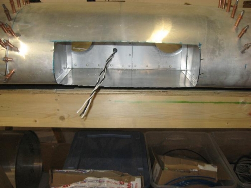

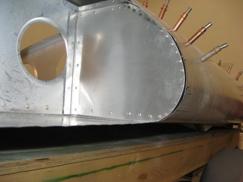

Cut the leading edge of the right wing to accomadate the landing and taxi lights.
Started to run wires. Built two false ribs to enclose the lights and provide stability to the leading edge. Night flying here I come.
I have prefromed in the oven a lexan lens for the leading edge. Not sure the method to install it yet. Probably will use nut plates and screws.
