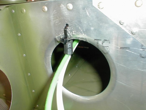

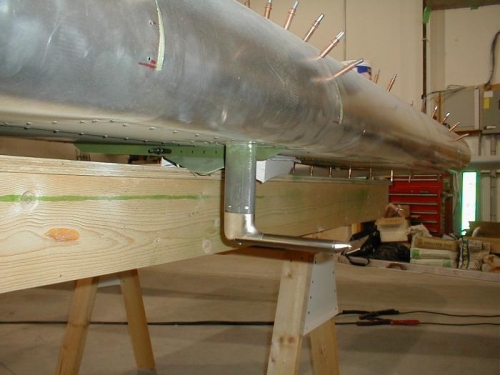

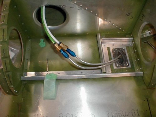

I made final connections to pito static in the leading edge of the wing. I used the "Safe Air" quick connects and tied off to the spar with a rubber hose spacer. Mounted the pito static to the wing and screwed tight to the backing plates and extra reinforcements.
