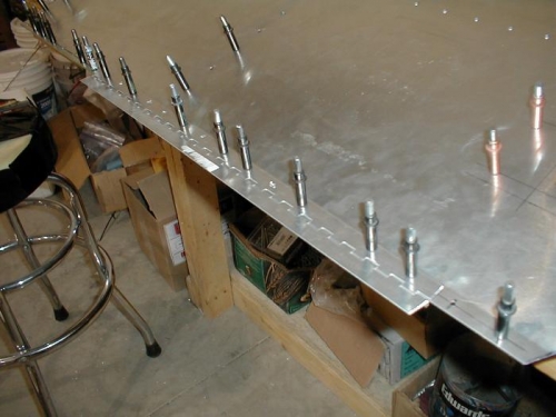

Cut out the access panel and control arm out of the elevator skin. Ran the wires through the grommet ready for a plug connection to the wiring to the panel. Mounted the trim servo with A5 rivets and installed the trailing edge trim tab hinge.
Showing sitting out of the access hole. I mounted and installed control arm
