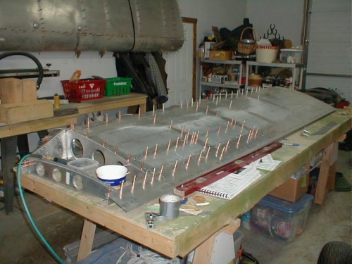

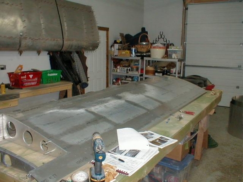

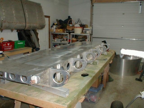

I have now placed the pre drilled top skin. Leveling everything and ensuring no twists I lined up the spar and the lines through the pre drilled holes. Clecoed everything togethor. I will still need to do the bottom skin and then I can remove and disassemble evrything, deburr and corrosion protect and then rivet on the bottom skin only
Top skin
Top skin
top skin drilled and celcoed

Bottom skin
Bottom skin
