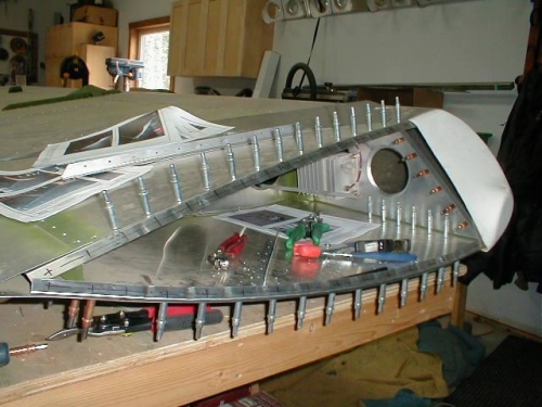

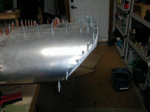

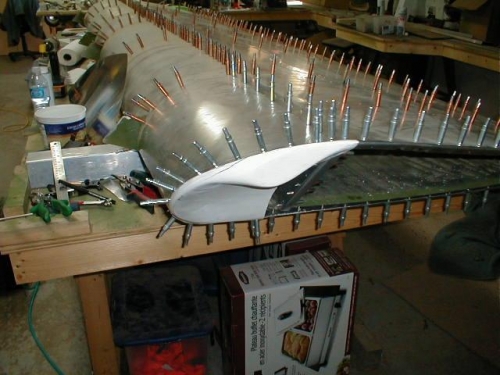

I took down the Left Wing and completed the wing tip. It was a tight fit getting the premade fiberglass tip in place. Crimped the L-Angles for the top and bottom and made sure that the crimps did not fall on the pre drilled holes.
