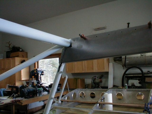

Spent most of the day trying to gete the pilot side frame correct. The pre bent 1/2" alum tubing was not quite the right shape for my opening. I used my template of plywood and filled the 1/2" tubing full with sugar. The sugar helps the tubing from crimping while your bending. The other option was to get a tube bender.

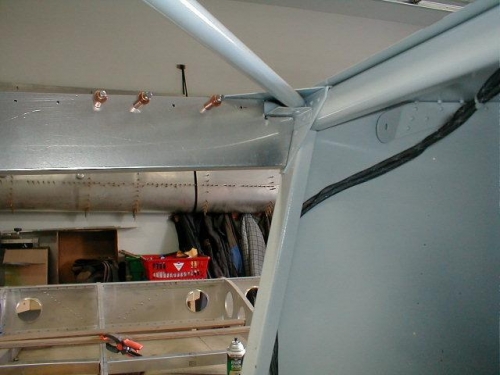

I got the correct shape and mounted the tube frame to the piano hinge that is already rivetd to the door sill. I shimed around the frame in the opening so that I was sure of clearance for closing. I then used duct tape to set the bubble door and align as required. Once aligned with the proper or required overlap, I back drilled a couple of holes in the hinge. Clecoed and held there until I could drill out the rest. Now I marked the perimeter overlap around the opening. Next I can mark and cut the gussests that are required in the top corners as well as add a top strip of .025 Aluminum to th etop of the door.
The instructions for the bubble doors I would have to say are incomplete. As well th edrawings do not rflect the bubble doors they are still showing the flat panel doors.
Bending the front of the frame around
Right Side Door Frame
