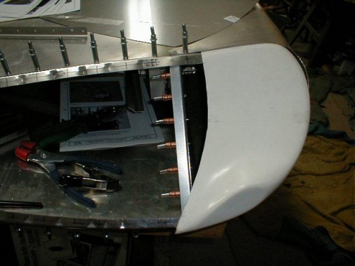

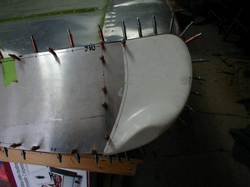

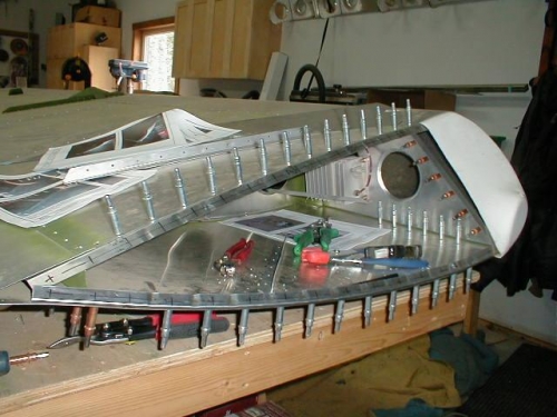

Cut the pieces for the wing tip skins. They needed to be crimped on both sides of the angle. This gives you a nice graceful compound curve. I took a little work to say the least, to get the preformed wing tip in place. Once clecoed and in place I was able to fit the end skin. I will still need to final trim.
Angles crimped and clecoed
Wing tip
Wing tip
fitting end skin
fitting end skin
