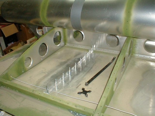

Wing Skin Stiffner
I added skin stiffners to the two wing cavities that do not have tanks in them. This should stop any potential oil canning in these areas. I will do the same on the right wing.
Clecoed
I used the crimper to get a curve that would hold the skin stiff
