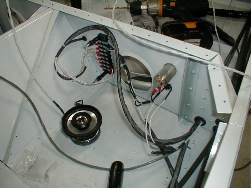

Added and wired in a music input and aux power. I wanted to be able to use my ipod on long trips. So i installed a jack under the passenger seat along with a 12volt aux outlet. I can then run a laptop or charge a external GPS or other device.
My XCOM radio has a pretty good set up for music where it wont interfere with rdio communications or intercom features. Not great sound though.
Located under legs of passenger
Comm speaker not yet mounted
