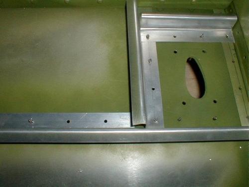

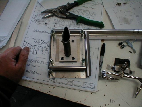

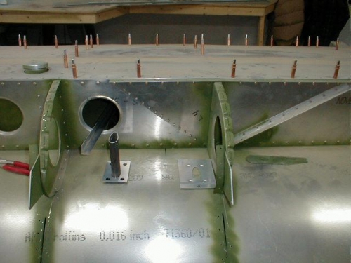

I imstalled the Pitot tube in the left wing. This is an aftermarket tube from Safe Air. It looks like a good set up, far better than the one that comes with the kit. This one works well with my Dynon system. I added stiffners to the skin and plates to ensure that it stays rigid.
