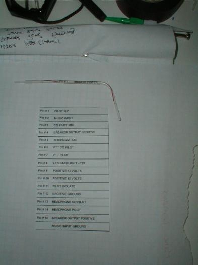

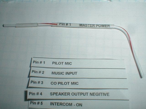

I took this idea of heat shrinking labels onto the wires, from an RV builder. Looks good and it does really help as there are alot of wires. I have at least 5 hrs of label and I know I have not got everything covered. I am sure I will be doing much more of this later.
I printed them off on the printer at a 6 font
Not bad
Not bad
