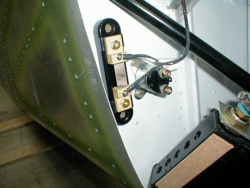

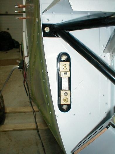

Brief Description:  Firewall Electrical
I installed the 40 amp shunt that came with the dynon package. I located it on the Right side of the firewall and positioned the starter switch next to it. They will have wire run between them. I attached the High and Low amp transducers from the Dynon package. Shrink wrap everything I can as I feel it keeps it clean and secure. I also drilled and installed firewall sleeves. Through those I ran the sensor wires. I drilled two one for the bulk of the sensors and the other for the exhaust gas sensors. I have sheathed all my wires in expndable wire sheathing from ACS. I have been using this as it works realy well to keep the wires together and it is durable enough to add plenty of protection against any movement.
40 amp Shunt
40 amp Shunt
Shunt and Starter Switch
