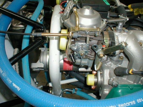

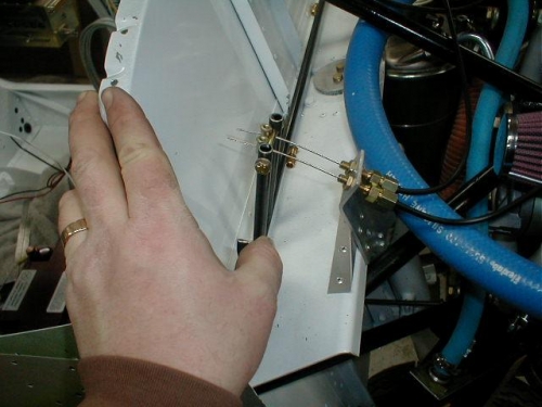

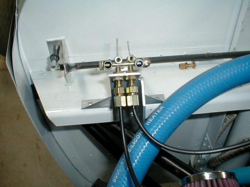

I used Rotax throttle cables that I had ordered with the engine but modified them to work with my firewall configuration. I cut them to length and used the terminations that ZAC provided to attach to the bell crank.
You can see the Rotax stock end to the cable. this will geive me an addtional point of adjustment
Both cables attached to bell crank
