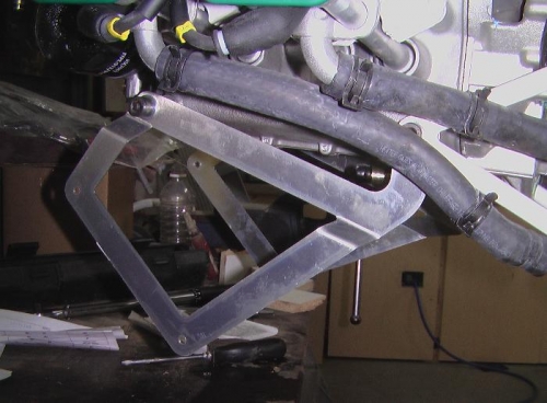

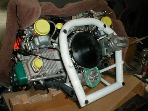

I completed the install of the ring mount on the engine. Mike Stiles was nice enough to bring over his engine hoist today so I was able to lift and install the radiator brackets with the ring mount. Thrust washers were rerquired on all but one location of the mounting points. I used "Loctite Blue" for all bolts and tourqued down to 310 inch pounds.
I need to order a 90 deg fitting for the lower left side of the water pump

Radiator bracket
Radiator bracket
