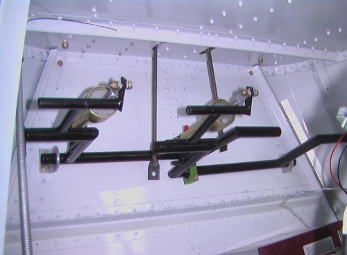

Date:  1-25-2008
Number of Hours:  2.50
Brief Description:  Rudder Pedals
Drilled and installed brake master cylinders. I checked alignment and foot position in the plane to be sure that they would be in a comfortable location. I marked the location and the rivet line to enure that the rivets, for the two end bearings, will be located throught the longeron on the fuselage floor.
