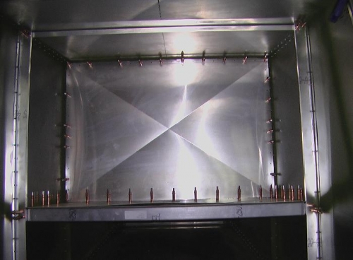

Brief Description:  Zee Channel and baggage compartment
Cut the zee channel as per the plans.Drillig small relief holes in the corners and then cutting with snips. Drawings I found a litle unclear as to when and where to drill holes into side uprights. Anyhow I added side wall L angles and proceeded with the install.
I then prepared the baggage floor. Cutting the holes for the controls in the corners.
