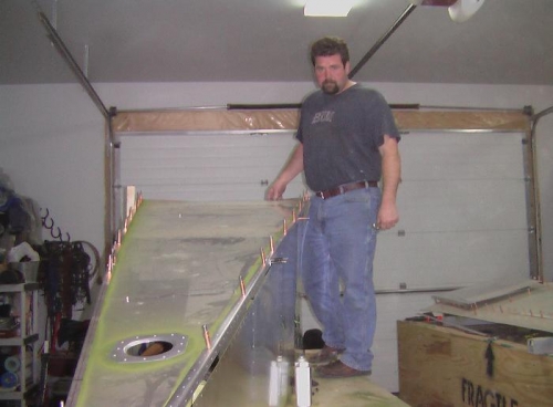

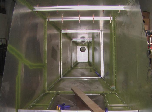

Date:  5-21-2007
Brief Description:  Top Skin Install
Installed the top skin. I set it on and clecoed the longerons. At this point I have not riveted the top skin L angles on. I squared the fuselage up with a plumb bob and brace. I needed to do this prior to dirlling the last rivet lines on the bulkheads.
Michelle took this photo
