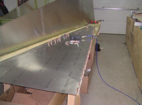

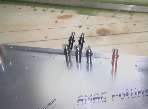

Started on the top skin. Removed the longerons for the side skin and matched to the top skin. Drilled and clecoed the longerons. I then cut L angle to the 4 locations on the top skin. Drilled clecoed and then removed, deburred and primed. I riveted the rear access hole doubler in place as well.
Longeron Lap
Longeron Lap
