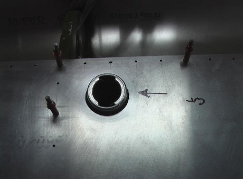

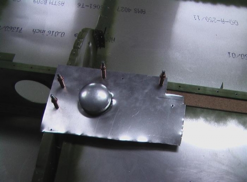

Brief Description:  Top skin
Created template for fuel cap loctions on top skin. I used scrap metal cut a 2.5inch hole and then located on the cap. I then used the strap duplicator to locate the hole on the main spar and rear rib. Next I located the same holes on the wing top skin and cut the holes using the template.
