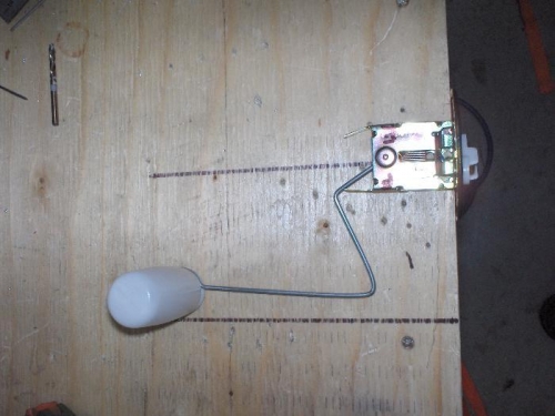

Brief Description:  Prepped Wing Fuel Tanks
I started to prepare the sending units for both tanks. First I had to shorten them to the appropriate length and adjust the float arm. There are two different types of units here. One will be mounted on top of the tank the other on the side. I will have a total of 4 tanks.
Shortened to 3.5
Shortened to 3.5". I will remove the bottom of the sender so it does not hit the tank bottom
