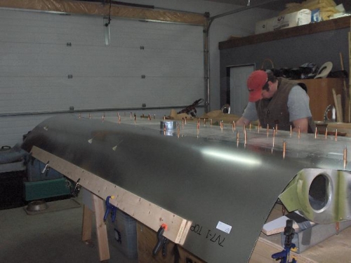

Re attached the bottom to skeleton. Holes lined up perfectly without adjusting. It took two pleople and some duct tape to align and set the nose skin. Fit perfectly. (love those pre drilled nose skins and slat slots.) Michelle was a big help here once she stop taking pictures and started helping. I used the wood to stop the skin fron getting any kinks. I drilled the bottom edge of the nose skin and started working on thevarious brckets and attachment points required.
Bottom skin installed and nose skin attached

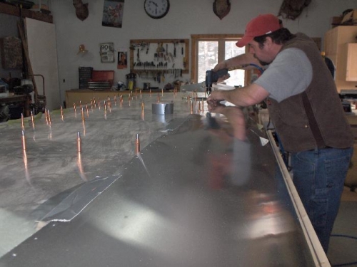

Duct tape really helps as a 2nd pair of hands

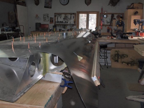

Wood on front is clamped on to stop any kinking of the skin
