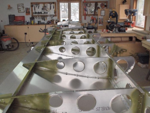

Brief Description:  Reattached the top skin

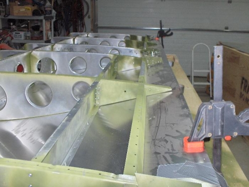

I reattached the top skin, clecoing every third hole. I then turned it over and leved it up so that the spar had no twists. I then preped the bottom skin so that it could be attached permanently when ready. I did not prep the bottom skin as it will need to come off again.
Sitting on table leveled and clamped
I will complete the zinc chromate when the skin is attached prior to wiring and plumbing
