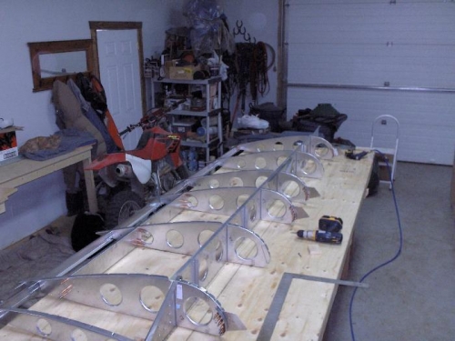

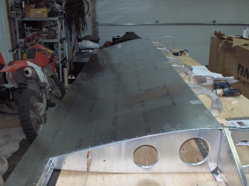

I first snapped a chalk line on the table. I then clamped the ribs and spar to the table making sure that the spar was perfectly straight with the chalk line. Next I laid the top skin over the skeleton and got the holes lined up. Using duct tape helped with this. Once everything was lined up I started drilling and clecoing as descirbed in the manual.
Securing the skeleton to the bench ready for the top skin
Getting the pre drilled holes lined up with the ribs and spar
Starting to drill and cleco
