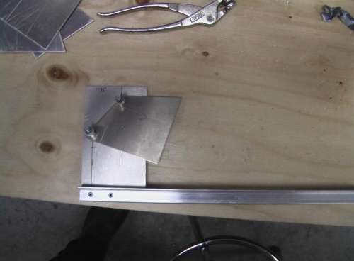

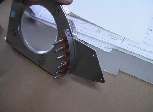

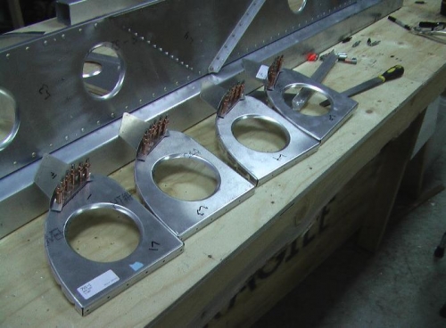

Built the alignment bracket for the left wing slat. If you build the bracket as per the plans the should work out perfect. I did drill my plates in two sets left and right clamped and drilled the stack of four all at once. Felt this would ensure that they remain exactly the same. Worked well need to do the other wing now.
Slat bracket alignment jig
One Bracket complete
One wings worth.
One wings worth.
