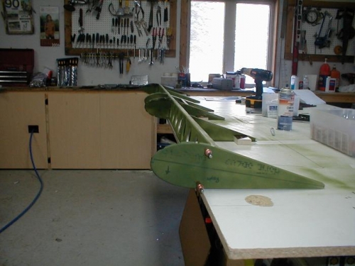

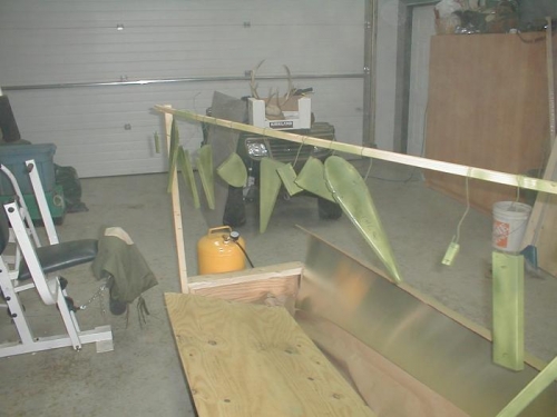

Disassembled and deburred all parts. Zinc-chromate and getready for reassembly. Riveted all the parts together with the exception of the end ribs. They did not show them riveted at this time so I am nottaking chances. I can rivet at anytime. Mounted to the bench with small blocks and squared up ready to lay the skin.
My custom spry rack. Send $5 for plans

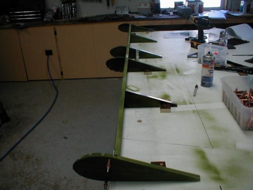

Looks good squred up and mounted to bench.
Screwed doen to bench ready for skinning
