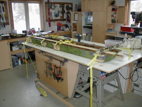

Was a producrive day. Duct tape proved very helpful set of hands once again. I followed the instructions and managed to get the Stab strapped downa dn nice and straight, no twists. I did however find the directions a little vauge on the process of when to rivet the bottom skin. I went ahead and began riveting. Stupid! Misse putting 7h2-6 brackets. Well the up side is that the skin will be riveted with A5 rivets. Like I said felt it was a little grey. I now look a few pages ahead to make sure before I rivet.
Skin strapped down
Skin strapped down

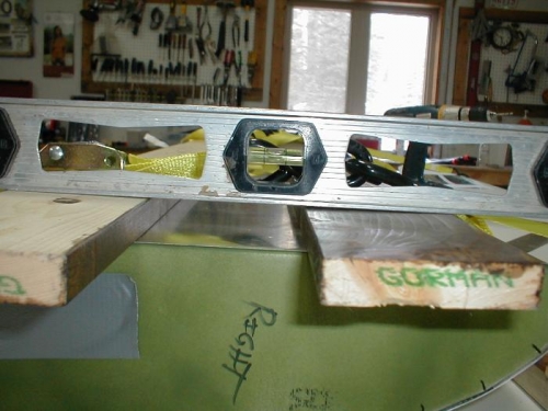

Leveling ensuring HS is not twisted

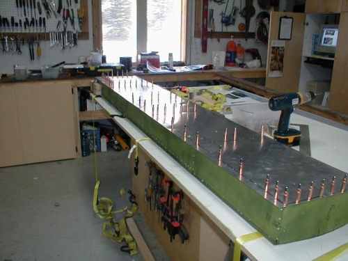

Drilled and  Clecoed
Drilled and Clecoed
