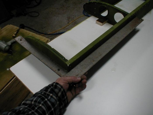

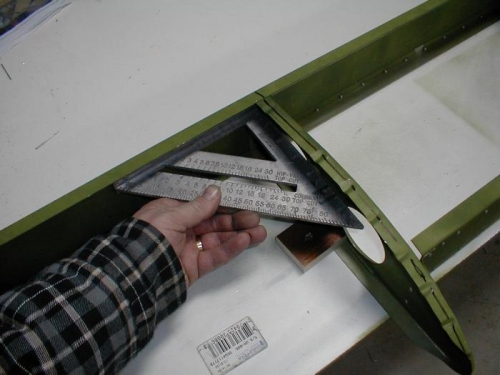

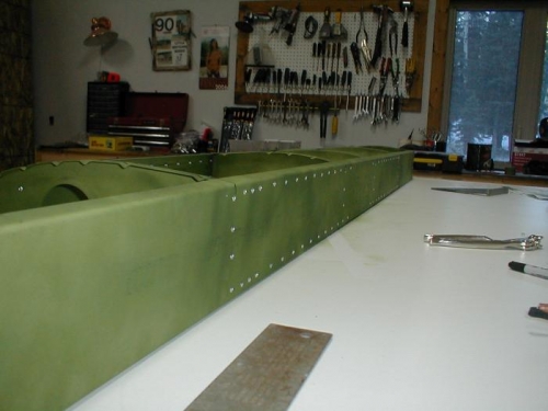

Squaring the HS Skeleton
Easy and quick. Made some blocks to clamp down the HS skeleton while I square it up and during the skin installation. Very easy just make sure that the ribs are square to spar and that the spar is perfectly straight.
