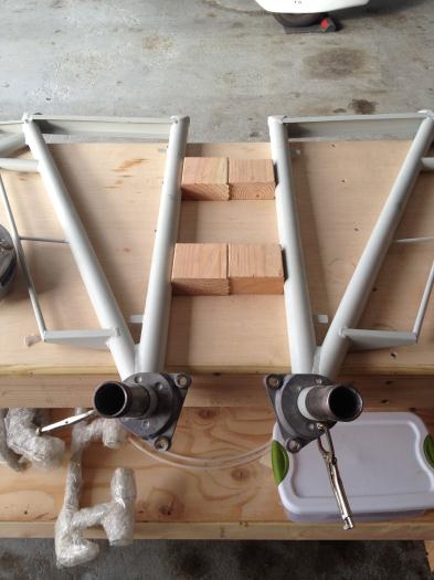

Brief Description:  Prepared for drilling brake torque plate mounting
Placement of the brake torque plates on the landing grear. Putting them side by side with blocks between them allowed me to square them up so they should be pretty closely matched on each side.
