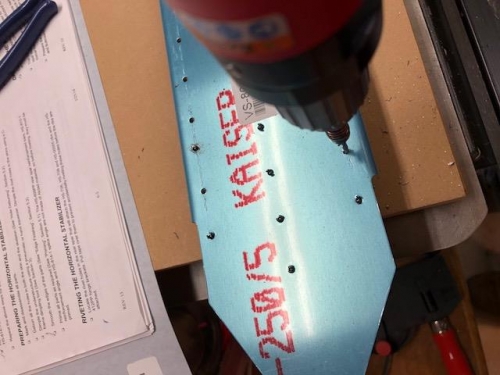

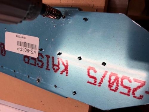

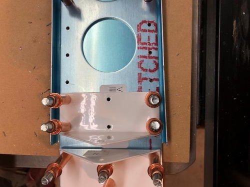

Brief Description:  Drill holes in hinge brackets.
The VS-410PP hinge brackets have two holes missing from the pattern. Use the holes in the spar channel and spar doubler as drill guides and back-drill the entire six-hole pattern through the upper VS-410PP only. The corner holes in the lower VS-410PP will be drilled for bolts later, in assembly with the fuselage (See DWG 78).
