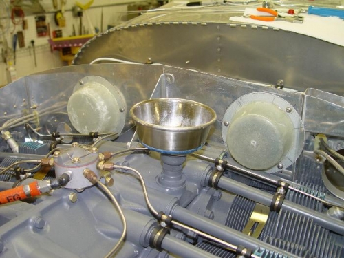

Brief Description: Added covers for engine mount bolts
Thanks to another builder who did this with a margerine container. - Simply lay 3 layers of cloth in the mold to form a cup(with lot's of mold release). - Trim edge flat - I mounted die grinder wheel in drill press a - Lay 3 layers of cloth on flat surface and invert cup on to it. - Trim, drill, finish.
I think I'll add cork gasket for best seal but really not needed.
