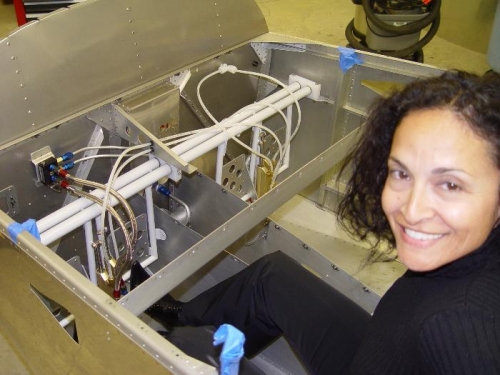

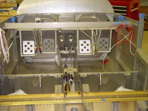

Brief Description: Installed brake lines and master cylinder
Found best way to insert brass sleeves in nylon brake lines was to use pick to push and twist them in. Heated pick for last cm. A real knuckle buster getting whole brass elbow assembly together. by the 6th and last one, could probably do them easily.
