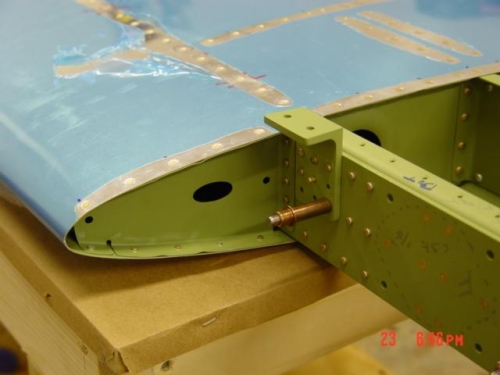

Brief Description: Riveted HS attach brackets - out of sequence
Brackets can be riveted last using power squeezer However, I discovered a major error - I left a half drilled rivet on main spar unriveted. Very difficult if not impossible to reach with bucking bar - may have to use pop rivet on this topside rivet.Then made it worse by punching out rivet and bending rib tab without fully removing old rivet - have to sleep on it..... Patience is key here
