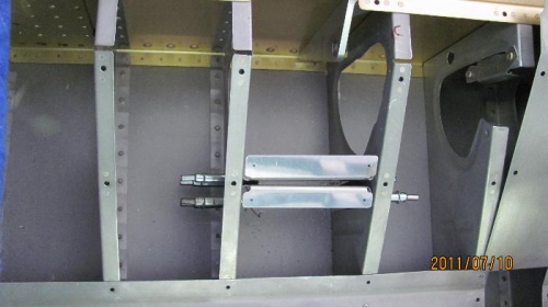

Date:  7-10-2011
Number of Hours:  1.45
Manual Reference:  Crotch Straps
Brief Description:  Crotch strap mounts
Started installing the additional crotch strap kit. This is a real pain in the ass on a quick build. I need a really small 90 degree drill but I dont wont to pay$400 for a couple of holes. Sand edges and deburr parts. Drill belt mount to 5/16 locate brackets against ribs and drill.
