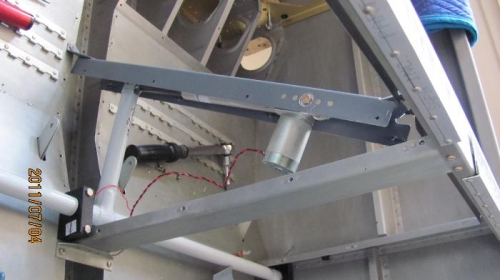

Date:  7-3-2011
Number of Hours:  5.15
Manual Reference:  Drawing 33
Brief Description:  Electric Flaps
Continuation of mounting flap motor and actuator. Drill safety wire holes in end of motor arm. Mount motor to bracket. Install in fuse and fit side panels. Drill rear support for nut plates for side panels. Prep channel adn install nut plates, refit side covers. Test motor operation. All is good.
