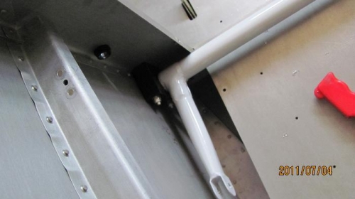

Date:  7-2-2011
Number of Hours:  4.50
Manual Reference:  Drawing 34
Brief Description:  Electric Flap motor and actuator
Open up the ends of the weldment to 1/4 inch as per plans. Drill F680 center block and cut it in half. Mount actuator arm (weldment) install end blocks and torque nuts to 25IP. Fit, prep and rivet electric flap mounting channel to fuselage. Install motor mounting brakets. Check angle on motor at 1/2 extension. Mount motor angles to channel. Prep aluminum and primer.
