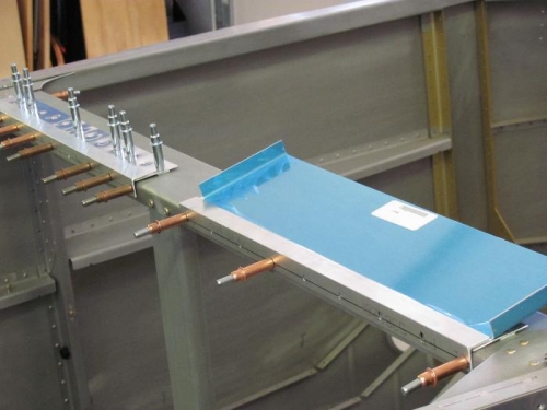

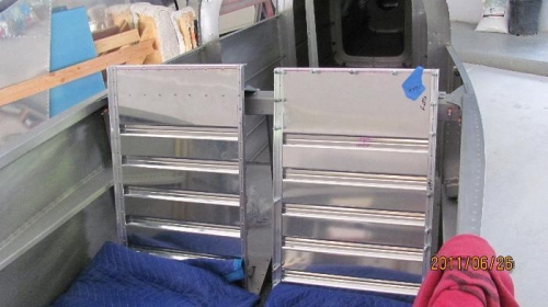

built seats backs today, drawing 30. Cut .125 angle for side support, cut top and bottom cross braches out of .063. Matched drilled and deburred. Deburred and riveted right seat back. attached to fuselage and sat in the bird! Made seat back support and cut lightening holes in them. deburred each. Located piano hinge adjustments on seat bottoms and on on seat backs to support bracket.
