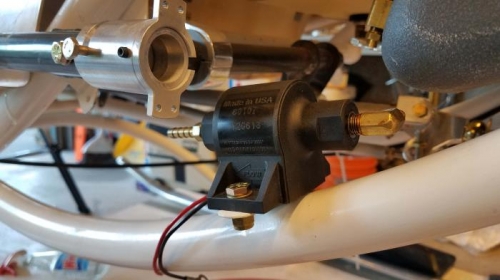

Brief Description:  Fuel pump installed
The fuel pump was attached to the fuel pump bracket. It's apparent that the fuel pump has changed since the original model as the holes did not line up. The bracket ears were bent up to match the holes in the new fuel pump. This cracked the powder coating, whicn then had to be sanded and resprayed.
Fuel pump attached
Fuel pump attached
